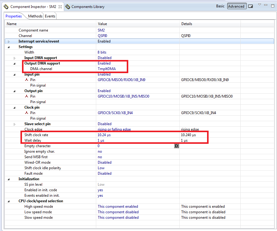

I have tried to reproduce the problem but the simple application with SynchroMaster component work properly with the Output DMA support enabled in the SynchroMaster component. I have used CW MCU 10.6 and 56F8400 tower board with MC56F84789 derivative (the MC56F84763 is a phantom). I used the default settings of SynchroMaster, set the timing (Shift clock rate = 10,24us clock, Wait Deleay 1us), enabled Output DMA support and I used a simple loop to send data (I have tested SendBlock() and SendChar() methods), see below:

I have encountered a problem with debugging only. When I debugged the application the QSPI (with DMA) does not send data. But when the application was run the data were properly sent (I have checked output signals from QSPI).

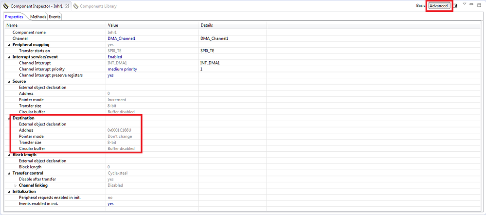

Please note that the Destination address of the DMA is set in the initialization code of the QSPI and DMA. It is a constant because the QSPI Data Trasnmit register is used (the word address of the QSPI0_SPDTR register is 0xE0B3 and byte address 0x1C166; see the MC56F847xx reference manua), see the DMA properties below:

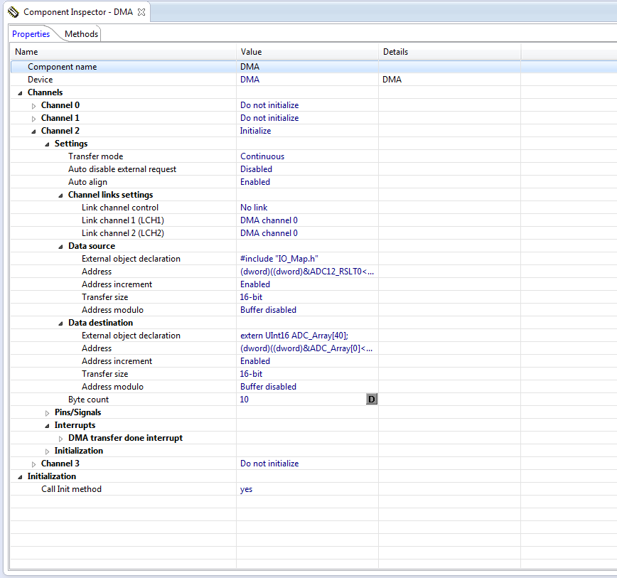

I am using DMA for ADC and would also like to try and use it for RS232 and SPI. My SPI settings with my dma on looks very similar? Did just running with Debuger unplugged allow your spi dma to work or did you have to change settings? I have attached a view of my DMA setup, and the pef for my whole project.

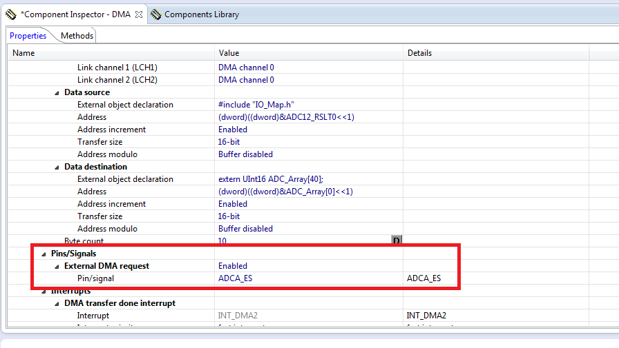

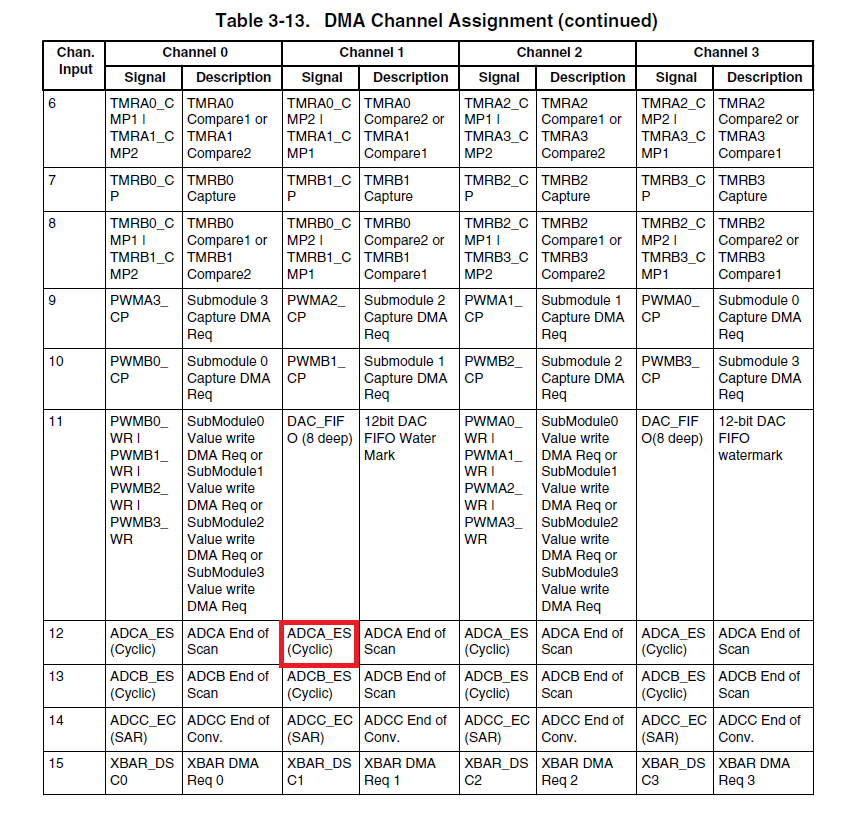

I have checked the settings of your application and it seems that there is missing settings of External DMA request in the DMA:Init_DMA component.If you are using ADC12_RSTL0 register and you want to copy results of ADC12 (Cyclic) to your ADC_Array you must select the right trigger signal that start the DMA request. In you case it should be ADCA_ES signal (ADCA (Cyclic) End of Scan). See screenshot below.
Note: You need also enable teh DMA request of the ADC12 device. It seems correctly configured in the settings of the ADC_MEASUE:Init_ADC component in your project.
