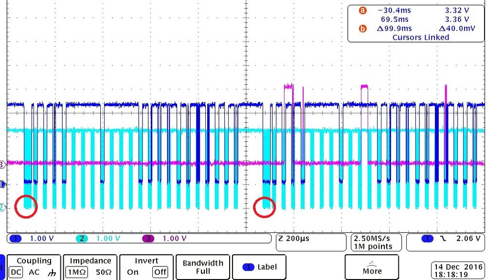

Hi All,
I am using processor KL16Z128 and KDS3.2 + PEx.
Because of speed and absence of SPI's input buffer I need to use SPI with DMA. If I set SPI parameters according to print screens attached below then every sent frame repeats its first byte (an extra byte is sent). How do I remove this extra byte? I found similar problem in discussion. It was solved with writing to register
SPI1_C3 = 0x01. I have to use SPI0 and SPI0 does not have this register. If I allow trigger on RxDMA then I can see repeated byte only in first frame but I do not receive any data! Does anybody knows how to solve this problem?

Without the trigger on Rx / Tx I do not receive data.
