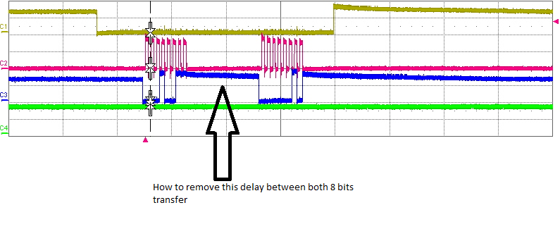

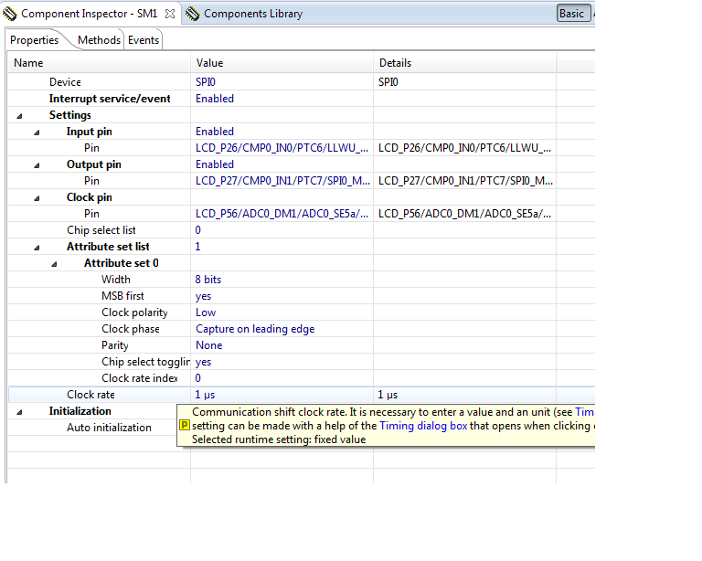

I'm using a FRDM board to send SPI command to an external part with processor expert and  SM1: SPImaster_LDD component.
here below the component configuration :
To send a SPI write command I used the following functions  and it's working fine:( I 'm using a GPIO to drive the CS)
static  uint8_t SpiWriteReg(uint8_t addr, uint8_t val) {
  SPI_CS_ENABLE();
  SPIWriteByte(addr); /* address */
  SPIWriteByte(val) ; /* data */
  SPI_CS_DISABLE();
  return ERR_OK;
static void SPIWriteByte(unsigned char write) {
  unsigned char dummy;
  (void)SM1_ReceiveBlock(SM1_DeviceData, &dummy, sizeof(dummy));
  (void)SM1_SendBlock(SM1_DeviceData, &write, sizeof(write));
  while(!spi_DataReceivedFlag){}
But I have a problem with such commands, because there is a delay between both SPIWriteByte(adrr) & SPIWriteByte(val).
Could someone explain me how to send the same information without any delay as shown in the below picture:
Thanks for your help
Rgds
Philippe
