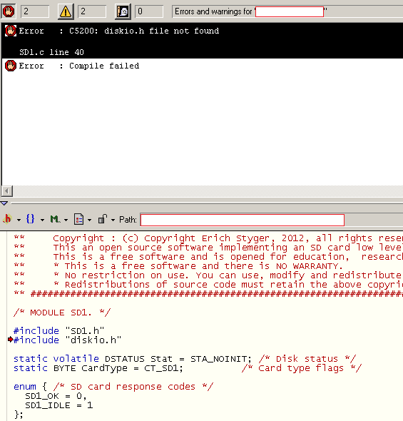

I was trying to add this beam, but i get this error message when I click on Make...
(diskio.h file not found)
I would like to know why
May be I'm doing somthing wrong...
Hmm, that would be a problem if you are using the component standalone. 'diskio.h' is the interface to FatFS.
I need to check the component sources, and I admit I have used it only in the context of a file system (with the FatFS component, see http://mcuoneclipse.wordpress.com/2012/07/30/fatfs-with-kinetis.
Are you planning to use the SD_Card component without a file system?
Erich
Actually it's my first time using SD card on embedded system. I'm planning
to use the SD card as part of a data logger with an MC9S12.
I want to save the data from an ADC on a csv file to be readed on Windows,
so I need a file system. But I dont have a good idea of how works the file
system.
Let me know If you have some information, sources that can be helpful...
That would be cool...
Cheers
On Fri, Sep 14, 2012 at 1:03 PM, Erich Styger <[email protected]
I'm doing that kind of things with ColdFire V1, V2 and Kinetis. I do not have a project to share for S12.
As for an example how to use a file system with the CN128, maybe have a look at
http://www.steinerberg.com/EmbeddedComponents/Examples/Example_CN128_FatFS/home.htm
