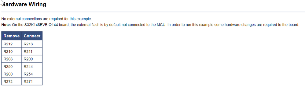

I ran the S32K148 QSPI example given within the s32ds and It was stuck inside the error trap loop. I saw many thread having the same problem. Did anyone figure out why there was such an error?

Alexis_A
Hello Austin,
In the SDK there's an example that uses the same peripheral, in the getting started for this example specify the following modifications that need to be done to run it:
Did you do these modifications?
