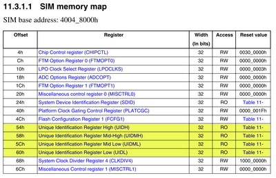

chao3
Hi,How can I obtain the chip ID of S32K144?
2,066 Views
lukaszadrapa

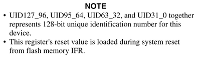

Hi @chao3
just read following registers in SIM module:
Lukas

chao3
OK!  Thanks!
