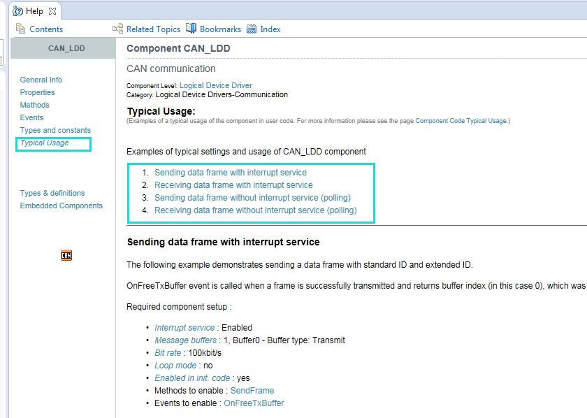

Hello Vinicius,
- Please check whether the interrupt vector for CAN_receive configured correctly.
- Also there is sample code , please right click CAN component -> choose "Help on component"->
Hope it helps
