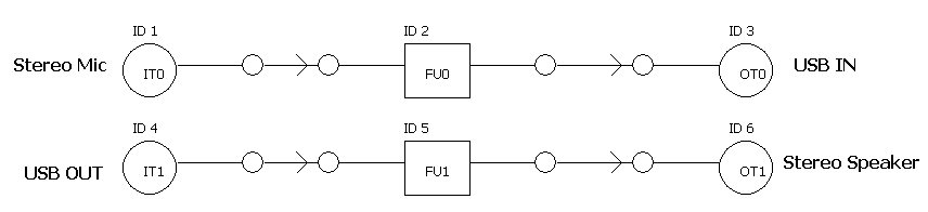

The USB audio topology is as follows,

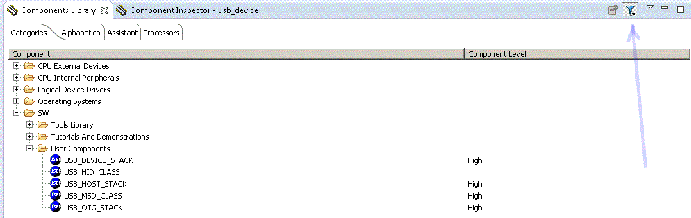

Question 1:  When selecting this MCU as the CPU in the project, I cannot find the USB_AUDIO_CLASS in the Components Library unless I change the filter setting.
If I switch off the filter, then the USB_AUDIO_CLASS appears. Does this mean the USB Stack 4.1.1 doesn't support MK20FN1M0VLQ12?

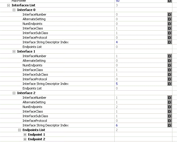

Question 2: When I change the settings in P&E, I cannot change the interface settings.
As the snapshot above, the interface is 3, what I expected is that Interface 0 is the control interface, Interface 1 is the Microphone, Interface 2 is the Speaker.
So, Interface 1 is expected to have an Isochronous In Endpoint, I want to assign EP1 to it, Interface 2: Isochronous Out, EP2.
But P&E don't allow me to change the settings, the Endpoints lists of Interface 1 and Interface 2 are both gray color, unchangeable, I don't know why, can somebody tell me why?
