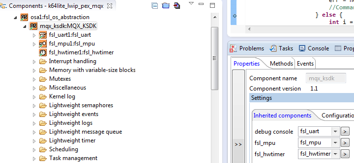

I have two projects, both setup to use PEx and MQX Standard.  One project has "debug console" as an "Inherited component" as shown below:
The other has "fsl_debug_console" as a "Shared component" as shown below:
I am pretty sure I created the projects the same way, so I must have done something different afterward, when assigning the UART.  But I don't know what I did.  The former example does not work, while the latter does.  I assume the non-working project isn't working because DbgCs1 is disabled in PEx (to get past the code generation errors due to conflicts), but I don't know how to remove fsl_uart1 and then make DbgCs1 a "shared component".  I tried to delete fsl_uart1 but it doesn't look like it's possible.  I tried to choose a different UART, but that doesn't work -- when I look at DbgCs1, KDS tells me this:
EDIT -- I just realized by changing from MQX to BareMetal and back, that one project was using MQX Standard (that's what I really want), and the other working project was using MQX Lite.  So to answer part of my question, MQX Lite "shares" the DbgCs1 component, but MQX Standard wants its own.  I vaguely recall reading something about this on the forum (I may have even responded to it...).
So perhaps the solution is to just leave (or delete) DbgCs1, and if that is the case, why is it that when I set up fsl_uart1 for MQX Standard that debug_printf doesn't work?  printf does work properly.

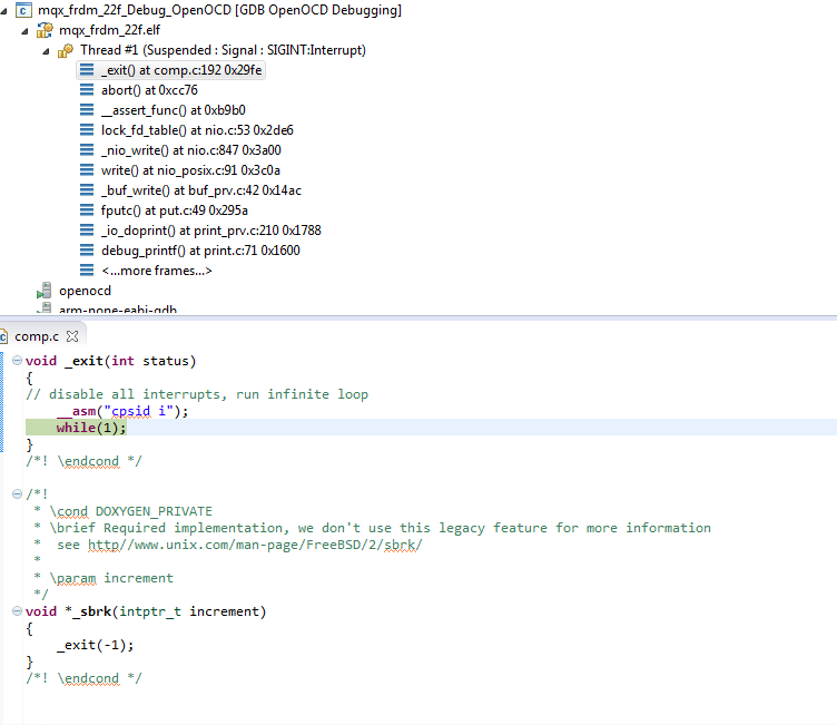

I have switched to MQX standard, deleted (or disabled) the PE debug console, and setup the appropriate UART for the target board....However after
compiling and testing it on the target MQX is asserting after calling the first printf statement it encounters......also when printf is called the first function it calls is puts() not printf()....I'm not sure why that is or where this is configured..
I have tried on two different boards with the same result.....a custom board AND also the FRDM-K22F dev board
Has anyone got printf working with MQX standard and wouldn't mind sharing their code?

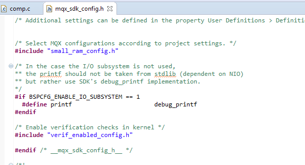

Ok so I managed to work out why printf is calling puts() in this definition in mqx_sdk_config.h.
I changed this to 1 to enable the I/O system it now calls debug_printf as per MQX_Lite..
Although the result is still the same....an assert fires after calling lock_fd_table() from _nio_write()
3,934 Views
F50SC
Update...
Ok so the above problem is when I use printf from int main {}........if I comment out the printf statement, printf functions correctly within the tasks themselves.
So it appears the problem is to do with printf outside an MQX task and from main..
3,934 Views
