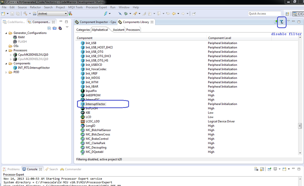

When using Processor Expert, the Vectors.c file that contains the interrupt table is automatically generated. What if I need to set some interrupt vectors myself, for code that coexists with PE?
Searching the forums only produced solutions that involve setting the file to read-only to avoid regeneration and re-incorporating changes manually after components are added or reconfigured. Surely there must be a better way?

Hi Jan,
is this for Kinetis/ARM?
You can use the InterruptVector component for this:
Note that you have to disable 'filtering' in order to see this component for Kinetis (this glitch already has been reported).

Oh, so *that's* why I couldn't find it! I saw mentions of InterruptVector component, but could not find it in the alphabetical component list. Thanks!
(yes, this is for Kinetis)

Please disable the filter in Components Library.
