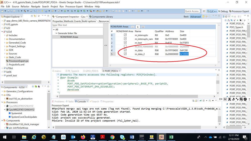

According to the product page (MK22FX512VLH12 Product Information|NXP) data sheet (https://www.nxp.com/docs/en/data-sheet/K22P64M120SF5.pdf) and reference manual (http://cache.freescale.com/files/32bit/doc/ref_manual/K22P64M120SF5RM.pdf) the MK22FX512VLH12 has 128kB of SRAM. But Processor Expert sees only 64kB of RAM. In the Memory Map view, there are two 32kB blocks (0x1FFF8000-0x1FFFFFFF and 0x20000000-0x20008000). If I go to the Build Options tab of the Component Inspector, the m_data and m_data_20000000 sections have a size of 0x8000. Increasing the size of these sections gives an error "There is no access into memory from 0x... to 0x..."
How can I get Processor Expert to work with the full RAM size specified for the MK22FX512VLH12?

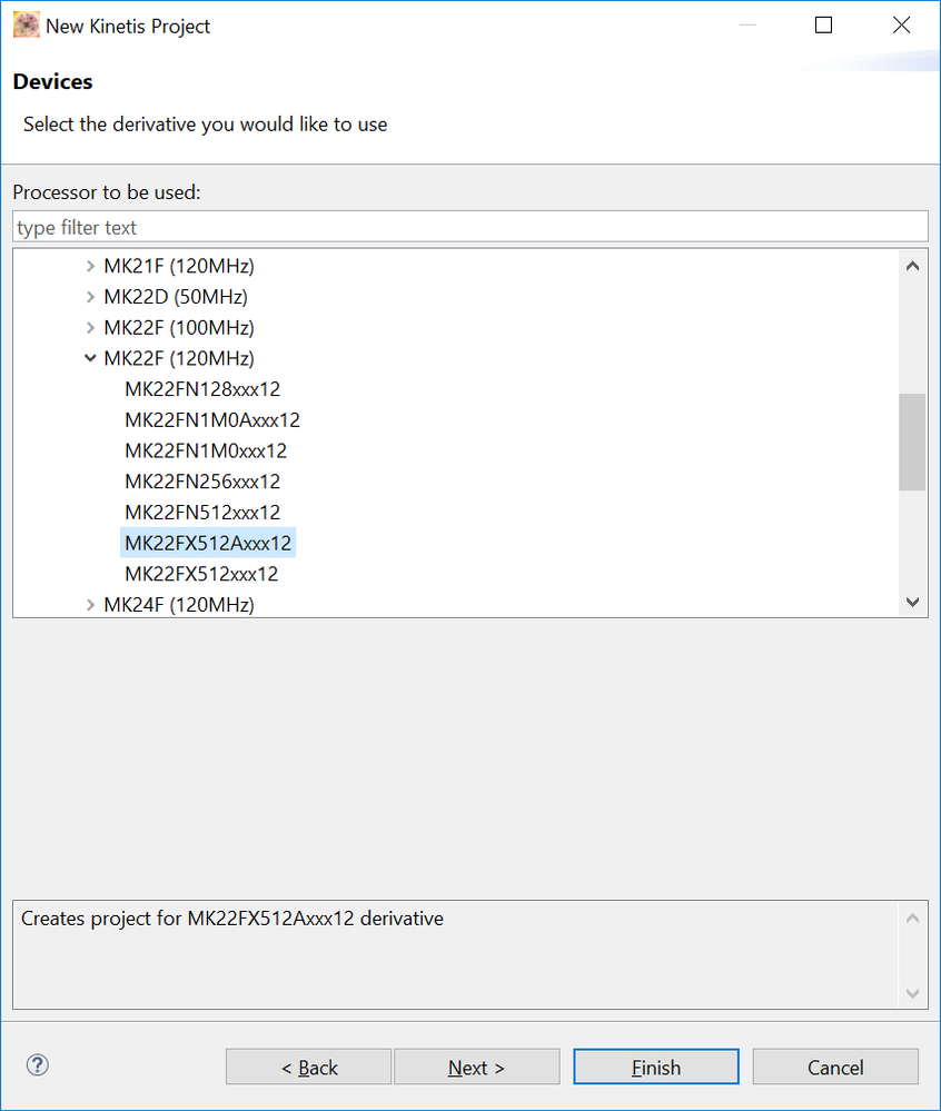

First of all, if this is a new project, please select MK22FX512AVLH12. Don't select MK22FX512VLH12. This device is fade out.

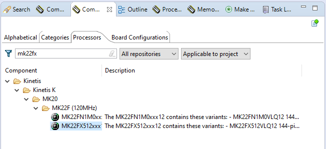

We are actually using the part MK22FX512AVLH12, not the MK22FX512VLH12. But Processor Expert does not seem to support the MK22FX512AVLH12 at all. So we are forced to select the MK22FX512VLH12 in Kinetis Design Studio. Here is a screenshot of what I see:

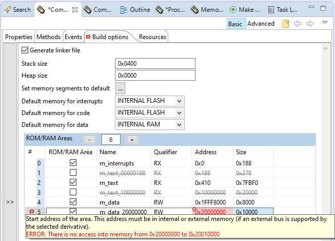

Finally, as I mentioned in my previous post, going to MK22FX512VLH12 > Build Options and changing the size of the memory areas gives me an error "There is no access into memory from 0x... to 0x...". Here is a screenshot of what I see:

You'd better don't start from MK22FX512VLH12. It has some slightly difference in peripheral register.
You can see in my above picture, I select MK22FX512AVLH12. Please flow:
File->new->processor expert project->(input project name)->select mcu
Jing

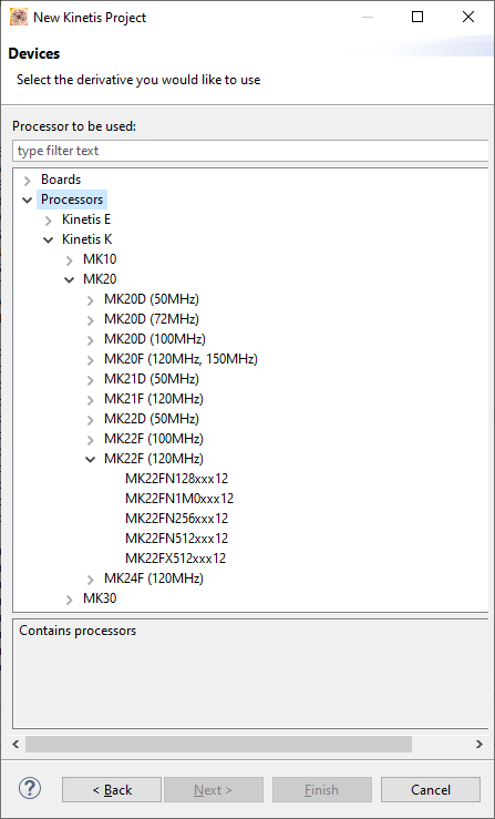

It seems like my version of KDS does not have the MK22FX512AVLH12. Here is a screenshot of the window when I go to File > New > Processor Expert Project > (Name Project) > Next:

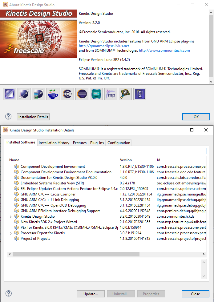

I think everything should be up to date, since I only downloaded and installed KDS back in January. Selecting Help > Check for Updates tells me everything is up to date as well.  Here is the Installation Details screen:

I figured out why KDS 3.2 did not support the MK22FX512AVLH12. The installation came with version 1.2 of the Kinetis SDK, instead of 1.3. Installing version 1.3 from https://www.nxp.com/design/designs/software-development-kit-for-kinetis-mcus:KINETIS-SDK?&tab=Design..., and installing the eclipse plugin through Help > Install New Software > C:\Freescale\KSDK_1.3.0\tools\eclipse_update makes the MK22FX512AVLH12 show up. It also appears that a project for the MK22FX512AVLH12 correctly supports the full RAM size of the processor.
It still seems like a bug that Processor Expert does not allow the MK22FX512VLH12 to use its full RAM. I tried manually editing the linker file and I was able to fill the full RAM properly, so this is definitely an issue with Processor Expert rather than the processor itself.
