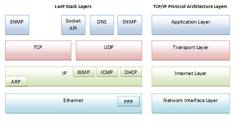

LwIP stack 1.3.0 introduction
LwIP is a small independent implementation of the TCP/IP protocol suite that has been developed by Adam Dunkels at the Computer and Networks Architectures (CNA) lab at the Swedish Institute of Computer Science (SICS).
The focus of the LwIP TCP/IP implementation is to reduce resource usage while still having a full scale TCP. This making LwIP suitable for use in embedded systems with tens of kilobytes of free RAM and room for around 40-100 kilobytes of code ROM.

The UDP packets are processed through the LwIP by the following way:

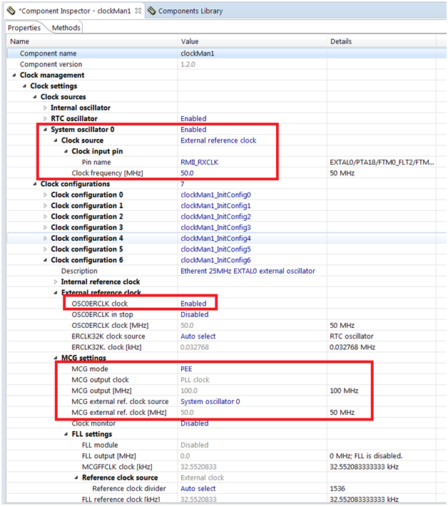

  • Clock configuration:
    • System Oscillator 0 – external oscillator 50MHz
    • New Clock configuration 6 – PEE,
    • Core Clock 100Mhz, Bus Clock 50 MHz, External Bus Clock 25Mhz, Flash clock 25MHz

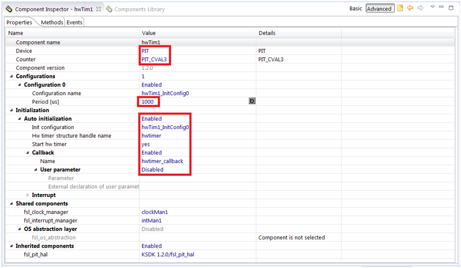

  • fsl_hwtimer component added into the PEx project. It is configured for PIT timer to provide LwIP timing functionality. It is configured by the following way:
