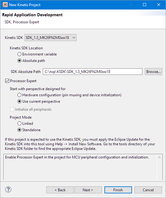

Are there any plans to support the K26 in KDS Processor Expert? The availability of PE support is a major factor in MCU selection for me. If I have a project that can be done with an MCU supported by PE, I use it. Not having PE support opens the decision up to other competitive product lines.

Hi Thomas,
if you add the SDK V1.3 from Welcome to Kinetis Expert | Kinetis Expert , then you can create SDK V1.3 Processor Expert projects
But it is true that there is no Processor Expert any more with the SDK V2.0.
I hope this helps,
Erich

thomasolenik
Interesting. I don't think I've ever selected SDK and PE at the same time. A lot of my projects require CAN and the SDKs are a little weak for CAN bit timing. PE makes it so easy.
