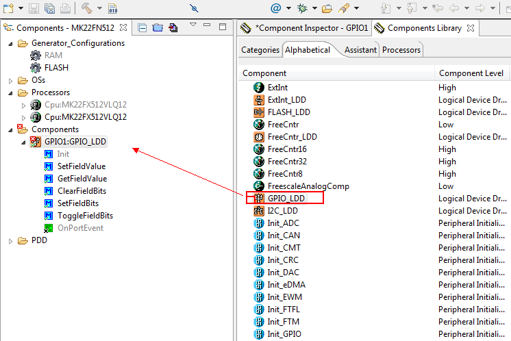

How do I go about picking the library item that I need to generate code to interface with a GPIO line?
What I need to do is configure a GPIO to send a signal to trigger a buzzer when a button is pressed.  I look at the Components Library and I am not sure where to begin.  I have inherited the code from previous developer so there are a number of LDD's already in the components list but I am not sure how they were created.  I noticed that they all have names which do not match anything in the Components Library, so I assume you can name these items what you like which I also hope to learn.

Hello Harold,

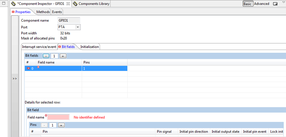

For example , when you want use the GPIO_LDD component , you only  need double click it , it will add under the project :
then configure it
If i misunderstand your meaning , please tell me your problem in detail.

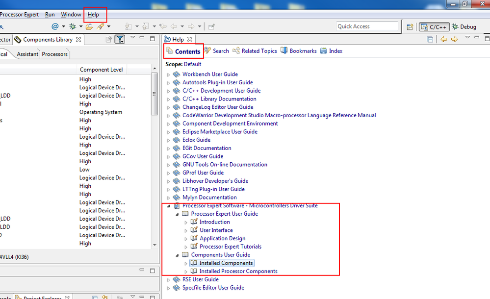

1. How do I know what item to pick from the ‘Components Library’ for the task that I wish to perform?
2. Is there a manual or some documentation that explains the Processor Expert and the Components Library and Inspector?

Hello John,
For the questioin 2, you can find the explains on "help->contents" :

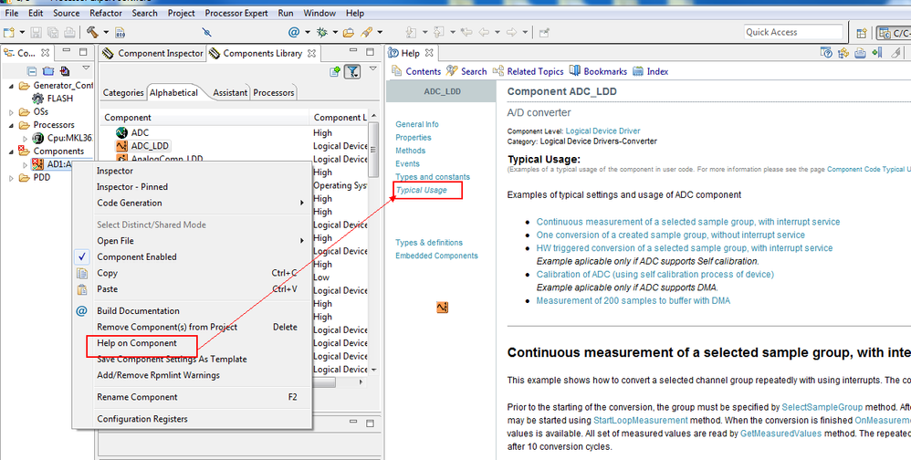

For the question 2, the components are most the chip's peripherals , it should refer to the requirement of your project ,
for example , if you want blink one led , you can add the GPIO component.  And there is "Typical Usage" about the components,
when you use the component, you can refer to :
About the buzzer. i think you only need one GPIO component or BitIO component ,
then you can also add one timer , through the timer interrupt control the GPIO pin output to High and low .
