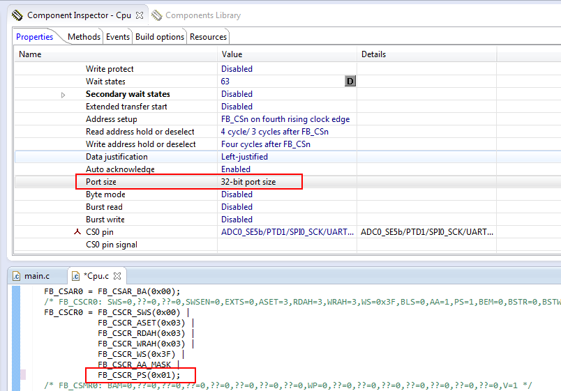

When I set Processor expert Flexbus (external bus) port size to 32 bits, It is actually setting port size to 8 bits.  I confirmed by looking at FB_CSCRn register setting in "generated code".  Has anyone else seen this issue ?  I noticed this because I am doing 32 bit wide read/write to external bus and the CPU is generating 4 bus transactions instead of 1.
Processor:  Kinetis K70
CodeWarrior 10.6
Windows 7 machine
Jim

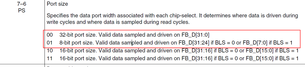

Hello Jim,
In the generate code , it seems have a bug , from the Reference Manual , when set the 32-bit port size,
the PS is "00", while the generate code is "01"(8 - bit port size):

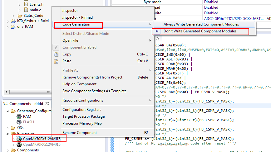

The workaround is change the "01" to "00" by hand , and in order to prevent the code change to "01 ," please disable the generate code of CPU at here:
