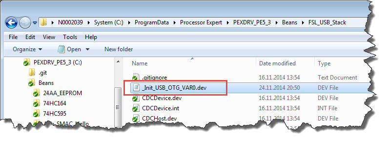

BlackNight
Hi Richard,
in case you are using the FSL_USB_Stack: I had to release a new drop because of that.
See McuOnEclipse Components: 17-Oct-2015 Release  for a description including the workaround.
It seems that the issue is caused by loading the wrong template file, so you could use the workaround of renaming the template file:
If you create a new USB_Init_OTG component without the template: make sure you set the Init settings as outlined in above article.
I hope this helps,
Erich
