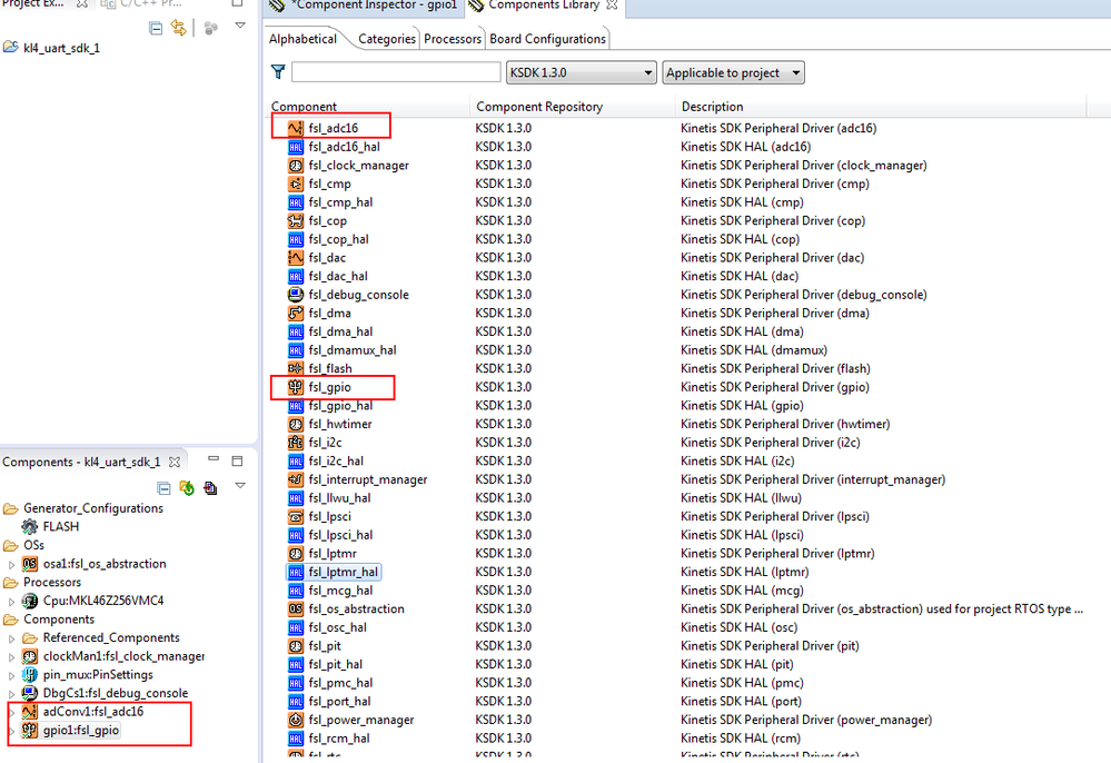

I've got a project set up in KDS 3.1 that's for a MKL03Z32CAF4 processor that's going to be running on a custom board.  The project includes Processor Expert and KDS 1.3.0.  I am an experience programmer having worked with TI and Microchip products extensively.  I know exactly what I want to do but it's not clear how to achieve it using the tool set described above.
I'm struggling with the basic pin setup/initialization - maybe it's already done but if so, that's not clear to me.  I think I need to define the pin usage in PE but everything I see in the colored tabs under Component Inspector - pin_mux that looks like it should be where I might select pin usage has a yellow pop up tool tip that says...
Automatic enabled - there is no user requirement for configuration. The value was selected automatically based on register configuration specified by other properties or based on after reset value.
I want to set Multiple output pins on Port A and Port B, ideally as masked port writes, I want to read a single A2D input on PTA9, and I want to detect button presses (buttons pull high) on PTA0 and PTB0 because I want to use the LLWU features.
I have looked for documentation that explains these basic steps but have not found any.  Please give me guidance on how to proceed and suggest which components are most applicable to my needs.

Jorge has a nice video at the link below showing how to use Processor Expert (PEx) to configure the KSDK fsl_gpio driver, using the PEx component Alice referenced for you.  And when you configure these PEx components to use pins, PEx will configure the pin mux settings for them.
Video Link : 3195
These "fsl_" components in PEx are based on the KSDK drivers.  Using them in your project will have PEx pull in the files needed for those drivers, and then PEx will configure the drivers based on your component property settings.  For example, using the fsl_adc16 component will include and configure the KSDK driver for the ADC peripheral, and allow you to configure which channels and pins to use.

Hello Ted,
About this words "The project includes Processor Expert and KDS 1.3.0" , do you meaning KSDK1.3.0?
If yes,  you can select the PE component you want to use in the "Components Library", for example
ADC module , GPIO ...
If still have any question about the usage , you can tell me without any hesitate.
