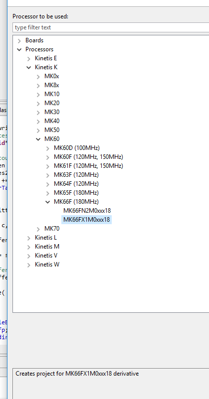

I am creating a project for MK66FX1M0VMD18 from scratch using KDS 3.0 and PE.
I am running the new project wizard (File -> New -> Kinetis Project ...) and select the processor:

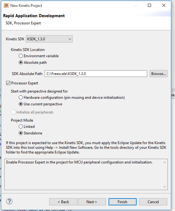

Then I select KSDK and PE:

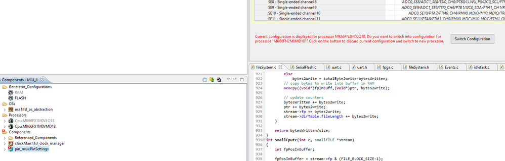

I select Finish and PE genrates code. Then I have to change to the correct processor package, the default is QFP, I am using MAPBGA
Default:
Is changed to:
Then the problems starts. PE complains about problems in pin muxing and ask if I want to switch to MK66FN2.... However this is the 2MByte part I am using the 1MByte part!
(In addition and N instead of X in part number, don't remember the meaning of that just now but not correct anyway))

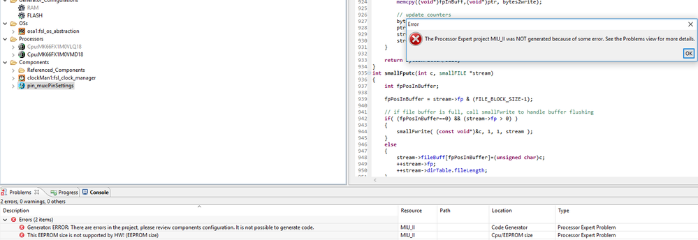

If I do the switch anyway I end up with the following error, probably becauce I have selected the 1MByte variant, but PE insists on using the 2MByte variant for some tests.
Can anyone help me?

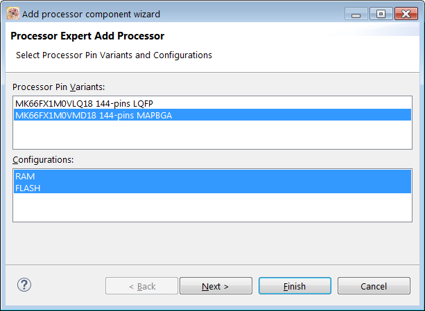

I have reproduced the issue and I have also reported the defect to Processor Expert development team.
You can use the following workaround:
When you create a new MK66FX1M0 project, navigate to Component Library and select MK66FX1M0x:
Select the 144-pins MAPBGA package
Click on the Finish button. The MK66FX1M0VMD18 CPUs are added and no error is reported (when the configuration is switched in PinSettings).

Hi Marek. I have tried the workaround and it worked. Thanks so mutch
