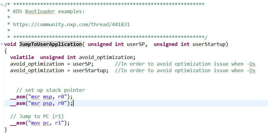

I need to develop my own bootloader program to update my application code. After reading lots of articles on the internet, the following are my developing setup and environment,
MCU: MKE06Z128VLD4 (Flash 128K, RAM 16K)
IDE: KDS 3.2.0 with Processor Expert.
Bootloader program  addr: 0x0
Applicaion program addr: 0x5000
Bootloader program:
There are a few example of bootloader on KDS with Processor expert, however, i found some and the following is the bootloader to jump to application code(0x5000).
(btw, i don't think it's correct to define SCB_VTOR in this way.)

After all those setting up, it works to jump from bootloader to application code!
However after jump to 0x5000, some of my application project run correctly, but some of application project didn't run.
I found out that the size of "bss" of application code will decide my application code run or fail,
If the "bss" size is less than 5K, then the application code run, if "bss" is larger the application will fail. This mcu has 16K for RAM.
My problem is why "bss" size affects my application code to run or fail? Is the bootloader code wrong? How do I fix it?

Hello Roger Chang,
‘bss’ is for the uninitialized data in RAM,  with data in RAM and bootloader use some RAM,
maybe more than 16K.
