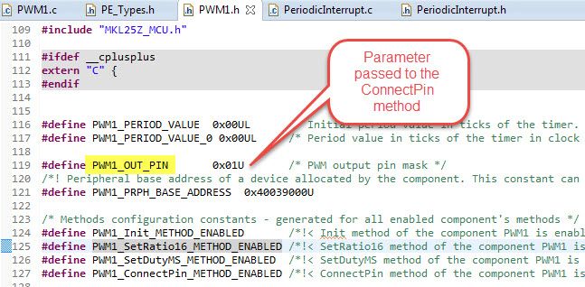

I am trying to setup a program that outputs a PWM signal but also has the ability to hold the signal on the same pin high or low 'manually'. The PWM is working fine, and I can disable it to simply hold the output low. However, the KL25 does not let me set the output as high. Therefore, I wanted to use a BitIO component to set the pin to high. I can add this component and it appears to work, using pin sharing.
However, the PWM component doesn't have a ConnectPin() method, so can't connect the pin back to the PWM output - it just stays stuck to the BitIO. I am using a PWM high level component. I see that the LDD has a ConnectPin method, but this is not available in the high level component.
I can use a PWM LDD directly, instead of the high level component, but I do not understand the arguments that need to be passed to the ConnectPin() function for the PWM LDD, what should the pin mask be?
Could someone help with how to achieve this...

The High Level components only support the common features of the LDD components, this means that the possible configurations are limited to the basic functionality of the peripheral, that is the reason why the ConnectPin() method is not available for the High Level Component.
Regarding the use of the method it has two parameters:
  • DeviceDataPtr: Pointer to LDD_TDeviceData - Device data structure pointer returned by Init method. Is the same pointer that is passed to all the other methods of the LDD component. The High Level Component do not use this parameter because is already generated by processor expert.
  • PinMask:LDD_TPinMask - Mask for the requested pins. The peripheral pins are reconnected according to this mask. This one is also generated by processor expert, you can check the value in the .h file for the specific PWM component. Here is an image for your reference:
You can call the method like this:
PWM1_ConnectPin(PWMTimerRG_DeviceData, (LDD_TPinMask)PWM1_OUT_PIN);
Hope this information can help you

abhiembedded
Thanks - both approaches worked for me, problem solved!
In the Processor Expert approach - I had to set the "Auto Initialisation" option to 'yes' otherwise I had no way of getting the DeviceDataPtr.
