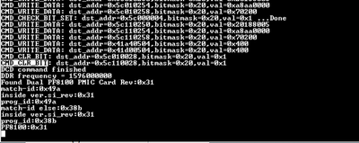

Hi NXP,
We are developed custom imx8qm-mek based board.
Imx8qm-mek uses pf8100 and our custom board uses pf8200.
Please let help me for board-bring up with pf8200.
Error: Found Dual PF8100 PMIC Card Rev:0x31
PMIC INVALID!
PMIC INVALID!
Please let me know where to change pmic settings.
we are using NXP.imx8-SCU DDR Test tool.

5,752 Views
rahulM
Hi NXP,
Please let me know.
I made some changes in platform/board/mx8qm_val/board.h
#define EP_PROG_ID 0x49AU  before--> 0x0417U
#define EQ_PROG_ID 0x38BU before---> 0x0418U
and platform/board/pmic.h
#define PF8100_A0_REV 0x31U before--> 0x10U
Please let me know what all changes has to be done for PF8200 in scfw version 1.2.1
Please find the attached screenshot from ddr_tester
Please reply ASAP, your solutions are well appreciated.
Thanks and Regards,
Subramanya N M
5,726 Views
Rita_Wang
PF8200 is already supported in the SCFW porting kit 1.2 release.
It will need to use CRC in i2c read/write operation with PF8200.
You can  try to add “#define PMIC_CRC” in their SCFW board.h file, and then the PMIC driver will use read/write function with CRC feature.
