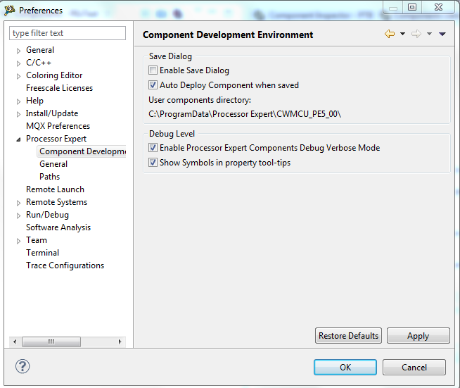

To see all symbols that some property generates you have to check both check boxes in Debug Level in Processor Expert preferences:

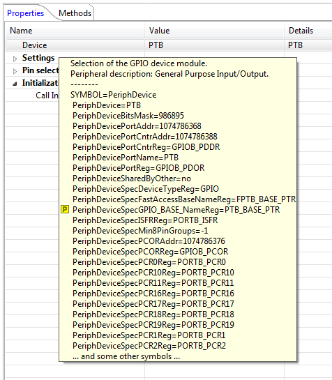

After you have done this, you can see some of the symbols of the property in it's tooltip (to see this you have to create new PEx project and insert the Init_GPIO component into it and generate the project):
If you don't find the symbol you need to work with in the tooltip, you can see all generated symbols and their values in file {component name}_DEBUG.txt after you generate the project:
All these symbols are however MCU specific and should be used with caution as they can vary between different MCUs.
