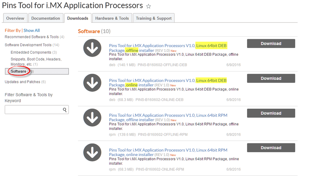

The Pins Tool is available as download from http://www.nxp.com/pinsimx (Windows, Mac OS X and Linux 64bit) under the 'Software' category.
There are two different installer types:
  1. 'offline' is a 140 MByte download. This method is recommended for slower internet connections or for installation on multiple machines.
  2. 'online' is a smaller download, all the other installation data will be loaded from the internet during installation.
Mac OS X and Linux installers are 64bit. For Windows there are both 32bit and 64bit installers available.

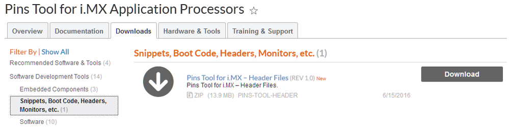

It is recommended to download the additional header files if not already installed/provided by your BSP because they are referenced by the initialization code. The header files are available in the following download under 'Headers':

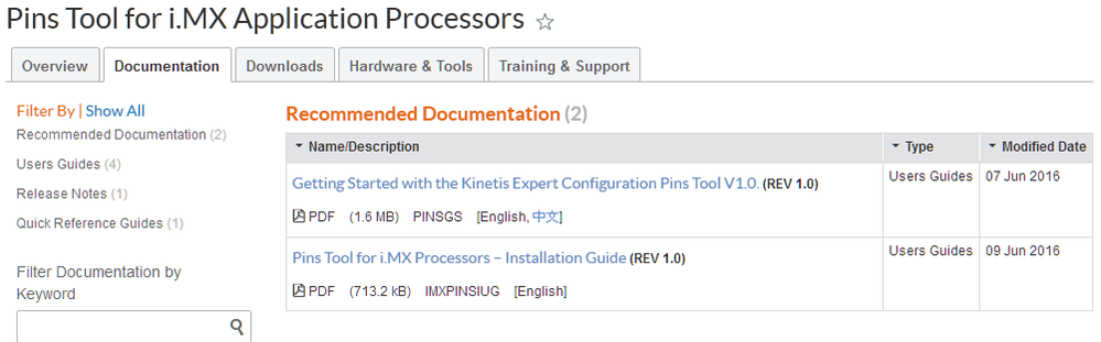

Documentation is available under the documentation section, as well attached to this article:
For installation, check out the installation guide. For first steps, use the Getting started document.

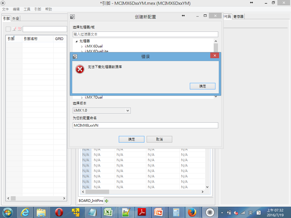

Hi Sir,
Can't create MX6UL 9x9 pin define.
Has any update file ?
Hi Apollo,
for which i.MX6UL device?
Erich
Hi Erich,
CPU is MCIMX6GxxVK
Error message:
Can't download CPU data base from server.
And other suggestion.
(1) Can add Language select in pin tool function ?
(2) Any CPU data base download from NXP web site and copy data base into pin tool folder ?
please try selecting the device again (creating a new configuration), because I saw that the NXP servers were down yesterday (it worked fine for me right now).

2) Data
There is intentionally no way to download dedicated data packages (it would be huge). Instead, you can find the downloaded data here (Windows machine):
C:\ProgramData\Application Data\NXP\mcu_data_v1
So you could copy that data if you want instead.
I hope this helps,
Erich
