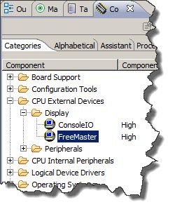

Thank you for posting the latest FreeMASTER component!  I have imported it into my Processor Expert Driver Suite and I do see some problems.
When I look at the Components Library in a workspace without any projects I can see the FreeMASTER component in the "CPU External Devices -> Display" folder.
When I create a project for either a Kinetis K (MK60DN512VLQ10) or Kinetis L (MKL25Z128VLK4), the FreeMASTER component is no longer listed in the Components Library.
It seems that Processor Expert does not think that the Kinetis devices are supported by this component.  I do not see anything in the "Help on Component" that indicates what devices are supported by this component.
The end effect is that I am unable to add the FreeMASTER component to a Kinetis project within the Driver Suite.

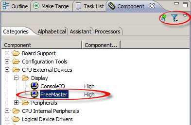

mmaas
Greetings Jaroslav,
Finally had a moment to go back to this exercise.  Indeed, with Component Filtering disabled, the FreeMASTER component is available in the Driver Suite for the Kinetis Architectures.
