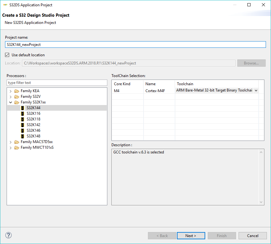

The easiest way, how to create SDK based project, is select SDK in startup wizard, please see the figures below.
Select microcontroller you want to use and insert project name. Click Next.

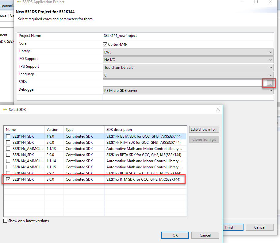

Click "three dots" button in the SDKs row...new window will apear, then select appropriate SDK. I recommend to use RTM 3.0.0 SDK only. Click OK then click Finish.
Processor Expert and some other windows will be opened.
