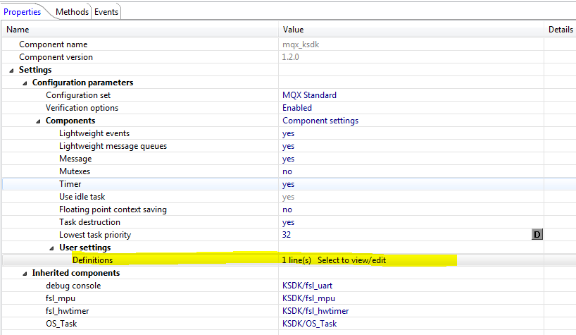

I'm using Processor Expert in KDS 3.0 with KSDK 1.2 and MQX. I want to set options such as the MQX_INCLUDE_FLOATING_POINT_IO but where is the recommended place to change these options?
I could just change it in PROJECT/SDK/rtos/mqx/config/common/mqx_cnfg.h but I'm not sure if that is correct?

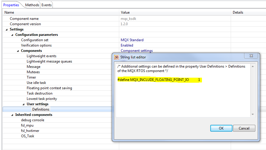

Hello Adrian,
for MQX configuration symbols definition is possible to use "User setting definitions" property which is placed in MQX_KSDK component:
Content of "User setting definitions" property is generated to "mqx_sdk_config.h" file (before include *.h file with MQX Lite/Standard configuration).

Thanks for the information. Component User settings sounds good. I tried that with KSDK 1.1 but the settings were written after the includes so good to see that has been changed now.
