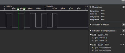

I analyzed the problem in detail and would like to present the result of my measurements.
I developed two programs. The first uses the CTIMER0 timer interrupt to toggle a CPU pin with a period of 20 microseconds (10 microseconds OFF and 10 microseconds ON).
The clock source for CTIMER0 is the Main CLOCK at 96MHz. As seen in the image, the period does not change both before and after the write operation. (see the  A1-A2 and B1-B2 cursors)
This means that the 96MHz clock doesn't change, but, as can be noted, interrupts are disabled for approximately 500 microseconds during the flash write phase. (see the C1-C2 cursors)
// PROGRAM 1
uint8_t buffer[128];
volatile int32_t OnOff = 1;
int main(void) {
	/* Init board hardware. */
	BOARD_InitBootPins();
	BOARD_InitBootClocks();
	BOARD_InitBootPeripherals();
#ifndef BOARD_INIT_DEBUG_CONSOLE_PERIPHERAL
	/* Init FSL debug console. */
	// BOARD_InitDebugConsole();
#endif
	memoryFlash.init();
	for(int i=0;i<128;i++) {
		buffer[i]=(uint8_t)i;
	SDK_DelayAtLeastUs(100, SDK_DEVICE_MAXIMUM_CPU_CLOCK_FREQUENCY);
	memoryFlash.flashWrite(buffer,128);
	while(1);
	return 0;
// INTERRUPT ROUTINE
void TestBit(uint32_t flg)
	GPIO_PinWrite(BOARD_INITPINS_RS485_TX_GPIO,	BOARD_INITPINS_RS485_TX_GPIO_PIN, OnOff);
	OnOff = !OnOff;
Image 1

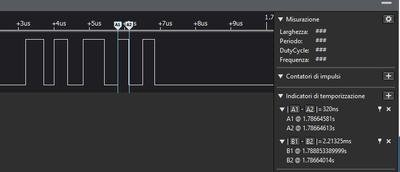

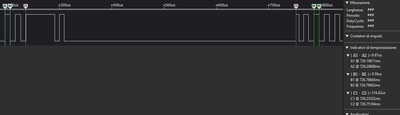

The second program toggles the CPU pin 10 times using a dedicated routine (togglePin).
As seen in the image, before the write operation, the period is approximately 640 nanoseconds (320 OFF and 320 ON).
(see the A1-A2 cursor on the image 2)
After the flash write operation, the half-period lengthens by about three times (from 320 nanoseconds to 1.52 microseconds) (wait states are probably being added).  (see the B1-B2 cursor on the image 3)
This obviously slows down the program execution.
// PROGRAM 2
flash memoryFlash;
static void togglePin()
	for(int i=0;i<10;i++) {
		OnOff = !OnOff;
int main(void) {
#endif
	memoryFlash.init();
	togglePin();
	togglePin();
	while(1);
	return 0;
Image 2

Therefore:
1) How can I prevent interrupts from being disabled during the flash write operation?
2) How can I prevent the program from slowing down after the flash write operation?
Thank you very much for your help and cooperation

You wrote:
->>It is not recommended to keep interrupts enabled during flash write operations. Disabling interrupts helps prevent data corruption.
However, I seem to recall that this is only true if, during the execution of an interrupt service routine, I try to read data or execute code that resides in the flash block I am currently erasing or writing.
->>After the flash write is completed, the program should not run slowly—this is not related. Regarding the clock, you can measure it using the clock output pin.
As you suggested, I followed the 'romapi_flashiap' example.
In the flash writing routine, you disable the microprocessor's cache memory but do not re-enable it at the end of the writing.
Therefore, after a flash write, the software's execution speed is lower.
(flashiap.c routine in romapi_flashiap example)
 PRINTF("\r\n Erase a sector of flash");
    status = FLASH_API->flash_erase_sector(&s_flashDriver, destAdrss, pflashSectorSize, kFLASH_ApiEraseKey);
    if (status != kStatus_Success)
        error_trap();
    /* Clear speculation buffer and lpcac. */
    speculation_buffer_clear();
    lpcac_clear();
// CACHE MEMORY IS DISABLED
    /* Verify if the given flash range is successfully erased. */
    PRINTF("\r\n Calling flash_verify_erase_sector() API.");
    status = FLASH_API->flash_verify_erase_sector(&s_flashDriver, destAdrss, pflashSectorSize);
    if (status == kStatus_Success)
        PRINTF("\r\n Successfully erased sector: 0x%x -> 0x%x\r\n", destAdrss, (destAdrss + pflashSectorSize));
    else
        error_trap();
    /* Prepare user buffer. */
    for (i = 0; i < BUFFER_LEN; i++)
        s_buffer[i] = i;
    /* Start programming specified flash region */
    PRINTF("\r\n Calling FLASH_Program() API.");
    status = FLASH_API->flash_program_page(&s_flashDriver, destAdrss, (uint8_t *)s_buffer, sizeof(s_buffer));
        error_trap();
    lpcac_clear();
As you suggested I
3,461件の閲覧回数
Hello @_Ferrari_
Thanks for your reply.
Yes, you are right. You can  enable the cache after flash operation finished.
Alice
