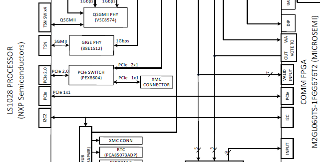

We have a LS1028A based custom board in which PCIe is connected to IGLOO2 FPGA as shown in attached block diagram.

I have attached diagram for PCIe and log file with this mail.
Please help us on this.

We have configured FPGA as PCIe End point,in which fpga memory BAR0 address connected with BRAM memory.
But now we want to transfer bulk of data from Processor to BRAM memory.
for this what modification is required in /dma/dmatest.c driver file and how i can test bulk data transfer from processor BRAM memory??.
Amit Keshri
