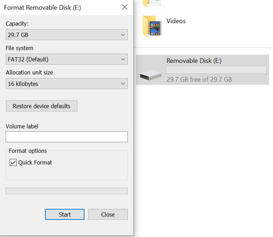

Ashrumochan
for your reference I have attached the screen shots .
Could you please have a look on them?
This is how i taken the example project.
This is how i used to format the card using PC.
Ashru

ZhangJennie
I tested 8G/16G/32G SD cards.
All these 3 cards worked well with the demo. UART3 output log file to terminal which showed these cards are well recognized and read.
Suggest you testing another card.
