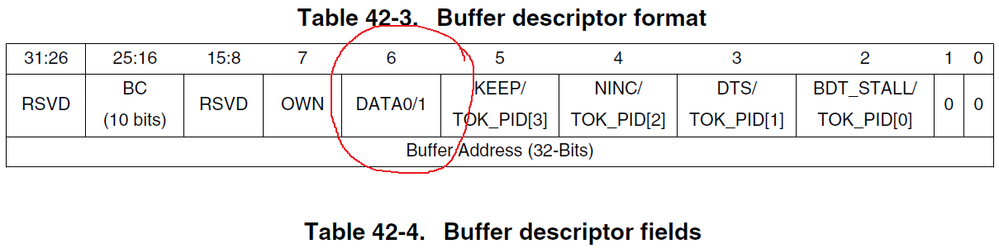

I am using the K20 with MQX Lite and Processor Expert, and I'm having a problem with the USB CLEAR FEATURE command.  The command is a CLEAR FEATURE (Endpoint Halt, Endpoint 1 IN).  After this command is handled, the DATA0/1 toggle is uneffected.  When I look at the code, and the documentation, there is a mismatch.  I've tried setting the DATA0/1 bit instead of clearing since the description of the bit is the last setting of this bit.  I have also used the value 0x40 for USB1_BD_LE_DATA1.  Nothing changes the behavior of the DATA0/1 bit when view with the USB analyzer.

#define USB1_BD_LE_DATA1                          0x40000000U
#define USB1_BD_LE_STALL                          0x04000000U

    BDPtr->CtrlReg &= ~(USB1_BD_LE_STALL | USB1_BD_LE_DATA1); /* UNSTALL ODD BD entry, set data toggle to DATA0 */
   (++BDPtr)->CtrlReg &= ~(USB1_BD_LE_STALL | USB1_BD_LE_DATA1); /* UNSTALL EVEN BD entry, set data toggle to DATA0 */

thank you for reporting this issue. We are analyzing the problem now because it seems that there is an error. We will inform you about the resolution.

I just received a response from the technical service request that said that I should move to the KSDK USB stack.  There is a suggestion to set the DTS bit along with clearing of the DATA0/1 bit, but when I tried that, it still had problems.
