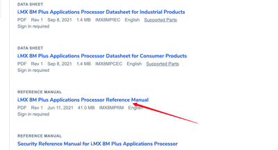

9,728 Views
Zhiming_Liu
Hi @PaulGerber
Please download this document:
Zhiming
