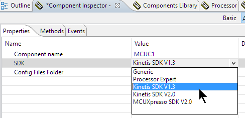

Hi Utsavi,
ok, now I see what is your problem. Are you using the latest version from SourceForge (see McuOnEclipse Components: 12-Mar-2017 Release | MCU on Eclipse ) already? If so, there is no need for the KinetisSDK component anymore. Instead, the McuLibConfig is used:
In the McuLibConfig, then configure the SDK version you are using:
I hope this helps,
Erich

Hi Erich,
Thanks for providing a guidance.
Yes I was using latest component from sourceforge. Yes you are right. When I used McuLibConfig component then I can generate processor expert code successfully.
One more thing is when I used older version of component then also this problem was solved.
There is nothing like SDK option selection in older version Utility component.

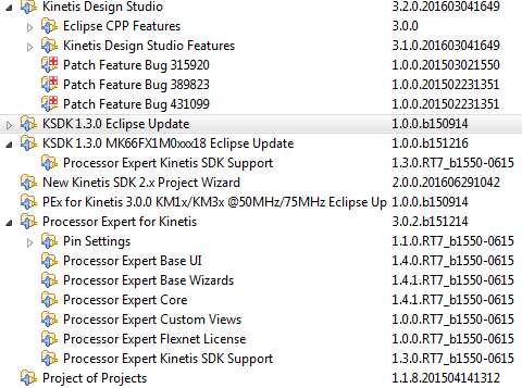

Hi Utsavi,
I have the same problem and was wondering if you solved your issue. I have the exact error you show in your screen shot with UTIL1. But I also have this issue with the CS1, TMOUT1, CLS1, WAIT1, and USB1:FLS_USB_Stack components. For me, everything was working until I added the USB1 component. Like Erich said, it relies on other components - CDC1, which relies on Tx1:RingBuffer, which relies on CS1. And CS1 has the same issue as UTIL1. But I don't know how to fix the lowest level components. They all reference KSDK1:KinetisSDK as you show in your screen shot. But I have that in Referenced Components and it has no errors. It seems like the other components can't find KSDK1.
My co-worker has a project set up in which these components all work perfectly. So we assume we have some difference in installation, paths, versions, etc, but after a couple of days of comparison, we haven't found anything.
I'm also using KDS 3.2.0. Here are screen shots of Installation Details and Components:
Roger Horton
5,602 Views
BlackNight
Hi Roger,
from your screenshot I see you have created a project with the SDK enabled?
The Kinetis SDK does not support the Processor Expert FSL_USB component.
Create a project without SDK:
Then you can use the FSL_USB component.
I hope this helps,
Erich

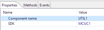

utsavikalpesh
Contributor V
Hi Erich,
Thanks for Quick reply.
Below is the error I am getting.
 I am using FreeRTOS and in KinetisSDK component I select SDK: processor Expert.
Below is the error I am getting in Utility component.
Can you tell me why this is so?
