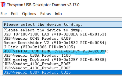

I developed an application based on LPC55 CPU that use USB connection to share data with Windows PC.
It works but I would like to show 'custom name' when I open Windows Device Manager tool on PC.
For example, if I connect Arduino to my PC the following messege is shown:
I would like to show my custom message (for example Ferrari device)
I don't know if:
- I have to modify the firmware on LPC55 to show custom message
or
- if I have to create custom Window drive to fix the problem
thank you very much for your help and cooperation

Hello, could you tell me how this appears at this moment on your side? I tried different examples, but in the USB the name does not appear of the example.

The followig image showa what I see on the PC monitor

Hello, thanks for your information for that you will need to modify the descriptor in usb_device_descriptor
/* Define string descriptor */
USB_DMA_INIT_DATA_ALIGN(USB_DATA_ALIGN_SIZE)
uint8_t g_UsbDeviceString0[] = {2U + 2U, USB_DESCRIPTOR_TYPE_STRING, 0x09, 0x04};
uint8_t g_UsbDeviceString1[] = {
    2U + 2U * 18U, USB_DESCRIPTOR_TYPE_STRING,
    'N',           0x00U,
    'X',           0x00U,
    'P',           0x00U,
    ' ',           0x00U,
    'S',           0x00U,
    'E',           0x00U,
    'M',           0x00U,
    'I',           0x00U,
    'C',           0x00U,
    'O',           0x00U,
    'N',           0x00U,
    'D',           0x00U,
    'U',           0x00U,
    'C',           0x00U,
    'T',           0x00U,
    'O',           0x00U,
    'R',           0x00U,
    'S',           0x00U,
Pavel

Dear Pavel_Hernandez,
I modified the software as you required but the problem still remains.

Hello, sorry but this will be an issue configuration of Windows.
