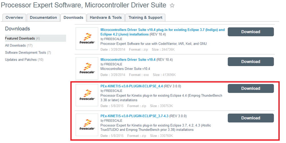

I have downloaded KSDK 1.2 and tried to follow the instruction for adding support into Pex but I get an error when trying to install the Eclipse update. It say it is missing a dependency as shown below:
Cannot complete the install because one or more required items could not be found.
  Software being installed: KSDK 1.2.0 Eclipse Update 1.0.0.b150420 (com.freescale.processorexpert.ksdk-1.2.0.sp.feature.group 1.0.0.b150420)
  Missing requirement: KSDK 1.2.0 Eclipse Update 1.0.0.b150420 (com.freescale.processorexpert.ksdk-1.2.0.sp.feature.group 1.0.0.b150420) requires 'com.freescale.processorexpert.feature.core.kpsdk.feature.group [1.2.0,2.0.0)' but it could not be found
I have searched to try and find the component but had no luck finding it.
First I tried to add it to Pex that already had KSDK 1.1.1 support then I tried to uninstall and install again on a clean Pex.
How do I update Pex?
Once I have got Pex working what is the best way to update my existing IAR + KSDK 1.1.1 + Pex projects?
If I have to move to KDS 3.0 how do I import and upgrade my old IAR + KSDK 1.1.1 projects?

Hi Adrian,
Could you specify which version of the Eclipse or KDS have you tried to use for KSDK 1.2.0 eclispe update installation?
The KSDK 1.2.0 is compatible with the latest version of Processor Expert for Kinetis (part of the KDS 3.0.0 or PEx for Kinetis 3.0).
You can find PEx for Kinetis download link on the Freescale page Processor Expert Software, Microcontroller Dr|Freescale
There are following variants:
If you are interested in porting of existing project in KDS 3.0.0, you can use KDS_3.0.0\doc\KDS_Porting_Guide.pdf document.
But you should be careful when you import an existing KSDK 1.1.0 project in KDS 3.0.0/KSDK 1.2.0 because KSDK 1.2.0 API has been updated and you need to verify all settings of imported components (PEx components properties).
