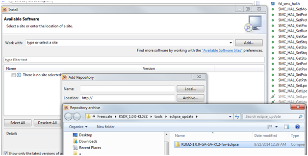

After the KSDK 1.0.0 for KL03Z is installed you need also install the PEx service pack for KL03. In the KDS main menu select Help > Install new software… , click on Add.. button , click on Archive and select KL03Z-1.0.0-GA-SA-RC2-for-Eclipse.zip in the SDK subfolder (e.g. c:\Freescale\KSDK_1.0.0-KL03Z\tools\eclipse_update\KL03Z-1.0.0-GA-SA-RC2-for-Eclipse.zip):
