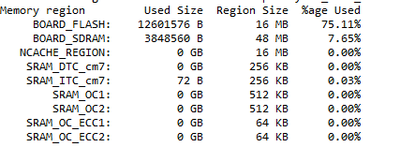

Now SD card is detected. In our case board flash memory is reached almost 75% and we need to move the image files to SD card.  Could you please provide the more details  how to move the image file to SD card. Once moved the data to SD how we can boot the system from SD card. thanks
FYI, I have attached board flash details here

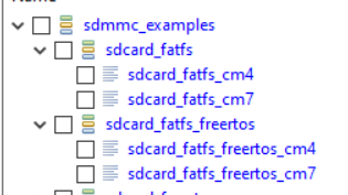

Pavel_Hernandez
Hello, for that I recommend reviewing the examples of FATFS.
