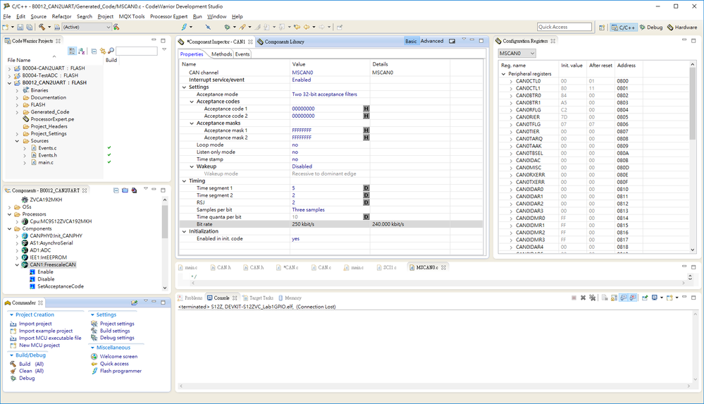

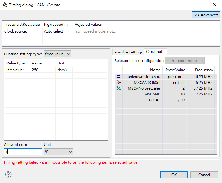

I would like to use CAN 250bps in Processor Expert.
MCU: S12ZVCA
Crystal: 12MHz
CAN 250bps
The parameter as follow:
The Error message as follow:
How to solve this problem? Any recommend?

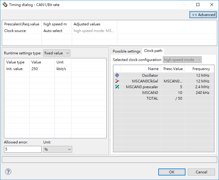

Hi Alice,
I got an error message when "Allowed error < 20"
I think there is a mistake with clock setting. So I change the "CPU - High speed clock"  from internal to external.
Than, error message is disappear.
Thank you very much.
Aaron

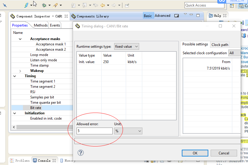

Hello Aaron Lee ,
How about the "Allowed error" in Bit rate configuration, you can configure it to 5%:
Hope it helps,
TIC
