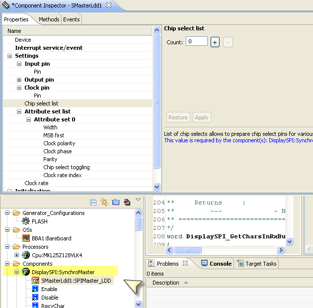

I'm relatively new to Processor Expert.  I am trying to use the SPIMaster_LDD component and I am having trouble hooking in a CS.
In the Properties dialog the "Chip select list" comes up with a count of 0.  The + button is the only button that is active but it does nothing.  If I type a number, eg 1 into the Count box I can the press Apply but the Count reverts to 0 and I am back to "square 1"
Any advice on how to hook up PTE4 as the CS to this component would be appreciated.
Many thanks
Colin

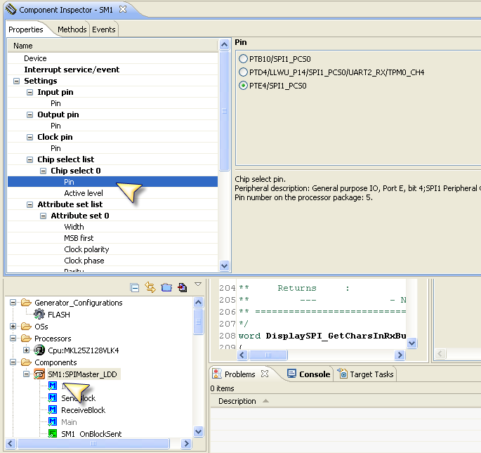

I have CW10.4 and have made fast test on my Freedom board. I do not see any problem here.
I have activated SPI1 and CHIP SELECT on PTE4/SPI1_PCS0
I have launched the never ending loop sending 4 bytes and I can see all signals correctly when scope is hooked up to outputs (CLK, MOSI and CS)
the whole project is attached, check this out - I hope this will help
Pavel

Thanks very much.  I imported your project and I can see the CS settings. I notice that in my project (on the right) I have an extra layer "DisplaySPI:SynchroMaster" in the component heirachy.
Any thoughts?

I just did some experimenting - Originally I had selected from the Component Library,  CPU Internal Peripherals > Communication > SynchroMaster.   I just tried Logical Device Drivers > Communication > SPIMaster_LDD
I think this is the approach you took in your sample.

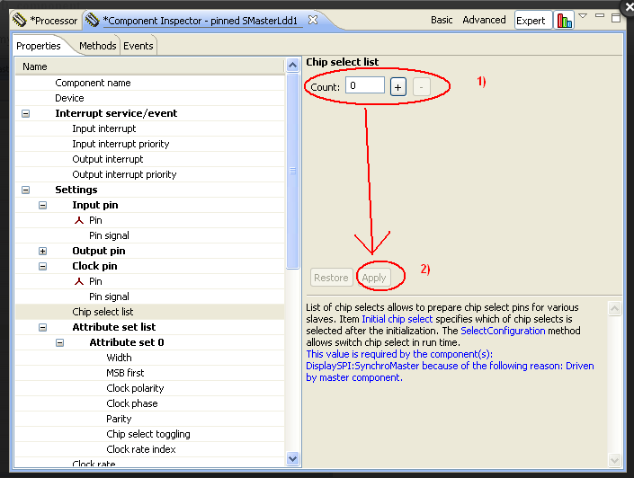

We try it and have no problem with chip select numbers with CW10.4 and last update. For just quick workaround, please try to go to the "Graphical Mode" of the property = those three color bars next to the Expert button in Component inspector. Here you can specify number of the chip select (on the MKL25 only one is possible) and push the Apply button. Then you can switch to the normal mode just by deselecting the Graphical Mode button. And then choose the appropriate chip select pin e.g. wanted PTE4.
Just for sure: If you don't see after all the PTE4, please go to the CPU component and try to switch the pin variant in the property CPU type.
I hope this works. Let me know.
Jiri

jch
Hi Colin,
1) Select the Count = 1, and then 2) Apply.
And it doesn't work?
Just confirm it.

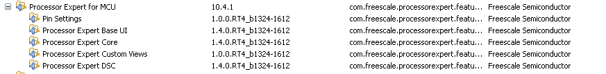

And can you please give me info about Processor Expert plugin version?
It is written in the many Help -> Install New Software and there is in right bottom corner link to What is already installed? -> Processor Expert for MCU Version.
Jiri

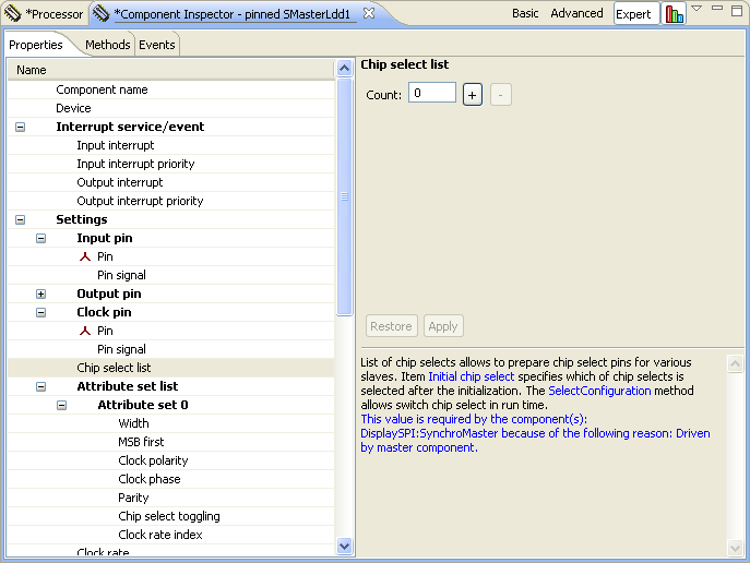

colinhoward
Hi Jiri
When I type a value of 1 into the edit box and press Apply the 1 instantly changes back to 0 (and the Apply button is disabled again).  I can see no other changes.
I am running XP SP3
Colin

colinhoward
Hi Jiri - I assume this is what you meant? Maybe I am doing something wrong but I cannot seem to get it to do anything.
