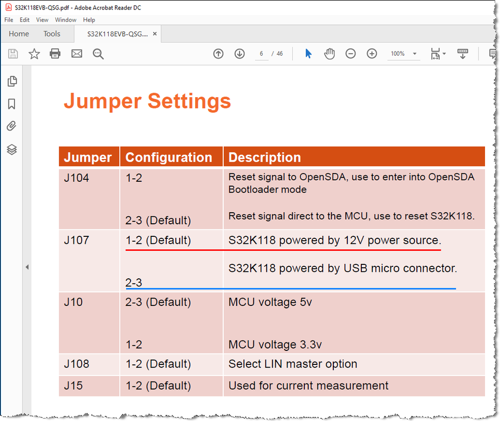

Hi!
       I just bought a S32k118 EVB development board. I wrote a little code and tried to load it on the board, but unfortunately I can't start it. I think it's a problem with the board because after I connect it to the USB port, it doesn't show me anything (no LED is ON and debugger shows me this message: "PEmicro GDB Launch Failure : Unable to auto-detect debug hardware"), I also tried to change some hardware jumpers, but the problem remained.
      Does anyone know if there is a hardware problem, or I missed something?
Thank you!

Please check the setting of J107. According to the S32K118EVB-QSG, the S32K118 powered by 12V power source by default. If you want to debug it by USB port, then you should connect Pin2-3 of J107.
