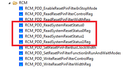

When I'm using ProcessorExpert on my HC12 targets I use Cpu_GetResetSource() to get the source of my current startup.
Is there any similar function for Kinetis?

The CPU_GetResetSource() method is not supported on Kinetis but you can use Cpu_OnReset(uint16_t Reason) event where the reset reason is provided as a parameter (value of RCM_SRS1 and RCM_SRS0 registers) or you can use PDD macros of RCM module, see below:

Hi, I was looking for the file RCM but I couldn't find it. I am using a M60DN512VLQ10
