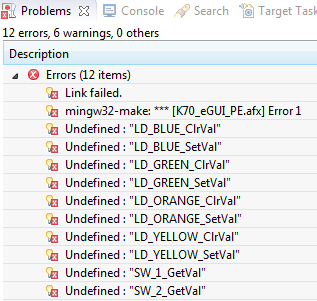

I've been working in a program using TWR-LCD-RGB (with eGUI) and TWR-K70 development kit. I need to change some objects in the user interface whenever a button is pushed. However, when I try to use the GPIO components available in Processor Expert (BitIO and Init_GPIO as shown in Tutorial: Bits and Pins with Kinetis and the FRDM-KL25Z Board | MCU on Eclipse )  several errors are reported, all of them regarding the definition of the methods of these GPIO components, as GetVal() or NegVal(). The exact error indicates, for example, that in the Component SW1 (BitIO) the method SW1_GetVal() in undefined. These error, nevertheless, are not present when the exact same code is used without the eGUI.

Hi Elisa,
I downloaded the project you mentioned, added a BitIO component to the project and tried to compile the project but got these errors:
I fixed these errors by including the corresponding header files on the demo_screen.c file.
#include "LD_BLUE.h"
#include "LD_GREEN.h"
#include "LD_ORANGE.h"
#include "LD_YELLOW.h"
#include "SW_1.h"
#include "SW_2.h"
Are these the errors you get? Could you post a screenshot of your errors?

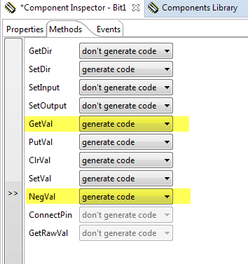

Carlos_Mendoza
Hi Elisa,
Are you using KDS? Please make sure that you set the GetVal and NegVal methods to "generate code":
And that the code is present on the generated files after clicking on the "Generate Processor Expert Code" button:

elisamejia
Hi Carlos,
I'm using Codewarrior 10.6, and I'm sure that they are set to generate code and they are generating it indeed.

Carlos_Mendoza
Hi Elisa,
#include "SW_1.h"
#include "SW_2.h"
Best Regards!
Carlos Mendoza
Technical Support Engineer
4,931 Views
elisamejia
Hi Carlos,
Those are the exact errors I get. However, I don't know why they started appearing, because as I told you, the project was working and didn't throw this kind of errors.
Anyway, thank you for your help!
Elisa
