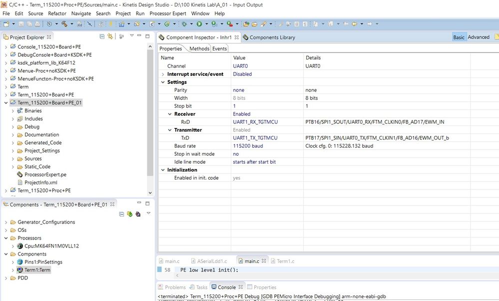

I wrote simple test program using on “Term” component.
do {
    Term1_SendStr("Press any key\r\n");
    Term1_KeyPressed();
    Term1_ReadChar(&ch);
    Term1_SendStr("\nYou pressed:\r\n");
    Term1_SendChar(ch);
     Term1_SendStr("\n**************\r\n");
} while(1);
This component is not supported by KSDK1.2 (on FRDM-K64F) so I select "Processor Expert" option.
Using:
  • “Board” option device:  FRDM-K64F No KSDK1.2  and Processor Expert (selected)
         SendStr() is working but ReadChar() is not working
  • “Processor” option  MK64FN1M0xxx12 No KSDK1.2  and Processor Expert (selected),
        making necessary modifications (CP{U type to 100 pin package and PinSetting Switch Configuration) ,
        The test is working perfect
Is there any explanation for this behavior?
Shaul

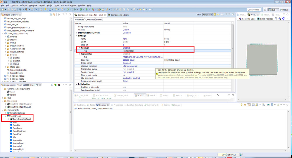

marek_neuzil
The problem is caused by routing of the RxD pin of the AsynchroSerial component (inherited by the Term component), see the following screenshot:
When you select the PTB16 pin in the RxD item (and also generate project and build the application again), the application will work properly.

shauldorf
Contributor V
Hello Marek
Attached my not working screenshot
Sorry it doesn’t help
Shaul

marek_neuzil
I am sorry but the application does work properly on my target board. I have also checked the generate code and it is the same. It seems that the issue is caused by your target board. The UART device is sensitive for precise clock source. I have noticed that you are using FEI mode of the MCG (internal oscillator of the MCU). Try to use an external crystal that is available on the FRDM-K64F target board. For example you can use the 50MHz external clock that is provided for RMII (external crystal is used that is stable and precise). You can set the PBE mode of the MCG and directly use this clock source for core and bus clock. See for example the attached application.
Please note, that your target board can be also damaged. If you have another FRDM-K64F target board try to use this other board to verify the functionality of the UART device and OpenSDA (OpenSDA provides virtual serial COM port on your host computer).
Marek Neuzil
