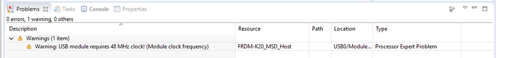

Can you post the exact warning you see, and which device you are using?
I'm aware of a bogus warning of the USBInit component complaining that the USB clock is not 48MHz, even if it is set correctly. Not sure if you see that one?

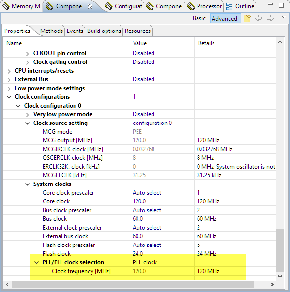

The other thing is: some of the clock settings might be different depending on the cpu/version you are using. I find them usually at the end of the CPU settings:
The above setting routes the PLL/FLL clock to the USB peripheral. Set it to PLL (at least for the most devices).

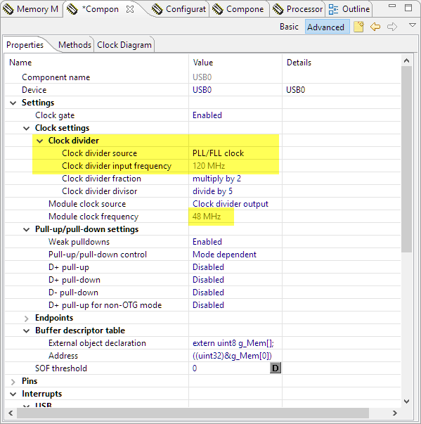

Then this clock frequency shall show up in the USBInit component like this:
Make sure you set the dividers to reach a 48 MHz frequency.

I was able to set the clocks and USB correctly. The error below is still shown but I think that is because they did not carry the property of the USB setting over due to the oversight in Tab Mode.

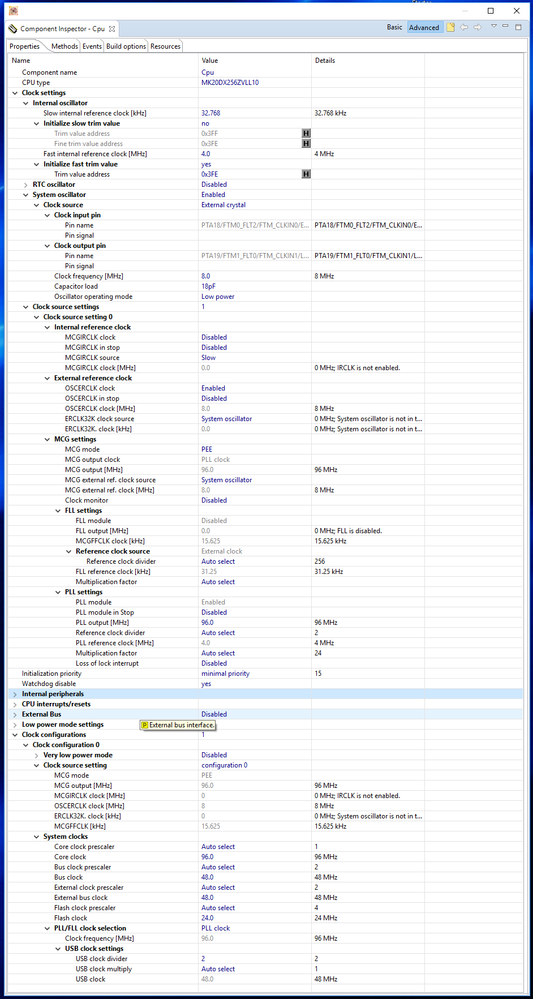

Here is what I have so far after changing to the MK20DX256ZVLL10 processor. I think it looks correct.
