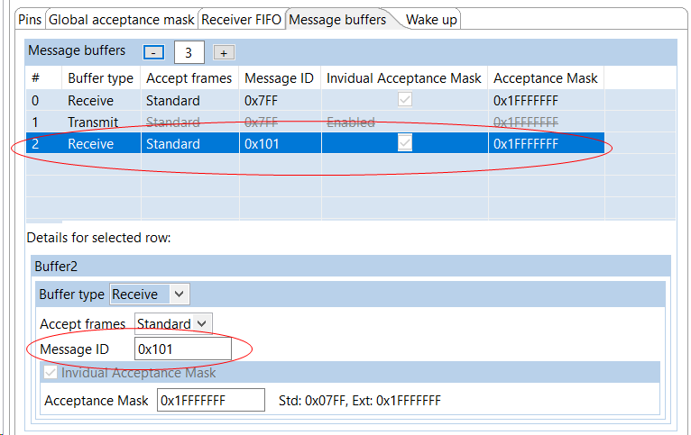

I am using
     K22 1M controller.
     KDS IDE
     Processor Expert
     CAN_LDD
I am not able to do Hardware filtering for CAN.
I want to filter ID 0x101.
   ID is standard.
   It is Data Frame.
Kindly suggest way to do.
1,499 Views

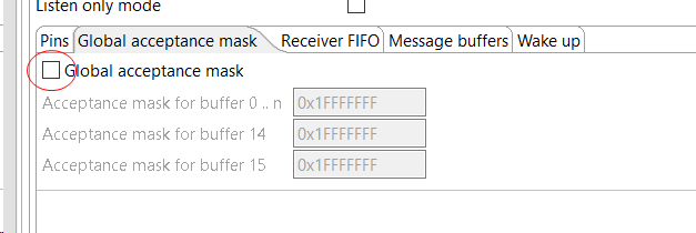

Hello sudhanshu mehta,
You can try to configure as below :
