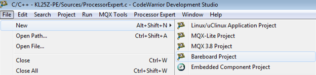

1. In the CodeWarrior , go for [File | New | Bareboard Project].

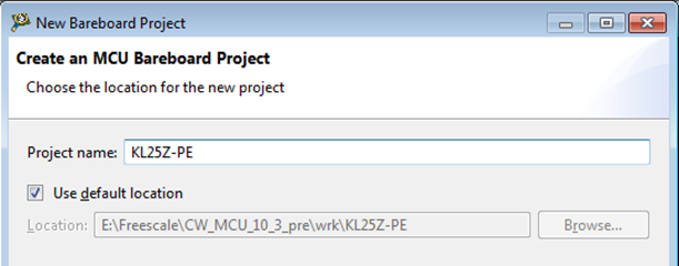

2. Type a project name such as e.g. KL25Z-PE” then click [Next]

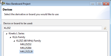

3. In Devices page, please go to the line [Device or board to be used], type in part of the name our target device:  "kl25z" and select the final target device MKL25Z128 from the filtered list.
Then click [Next].

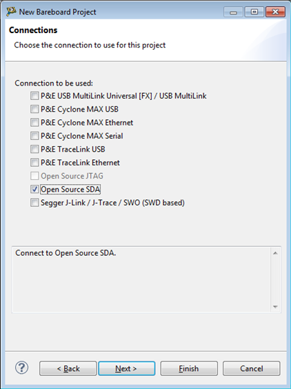

4. In the Connections window select only the [OpenSource SDA] connection type and click [Next].
Note: This is the on-board USB debug connection on FRDM-KL25.

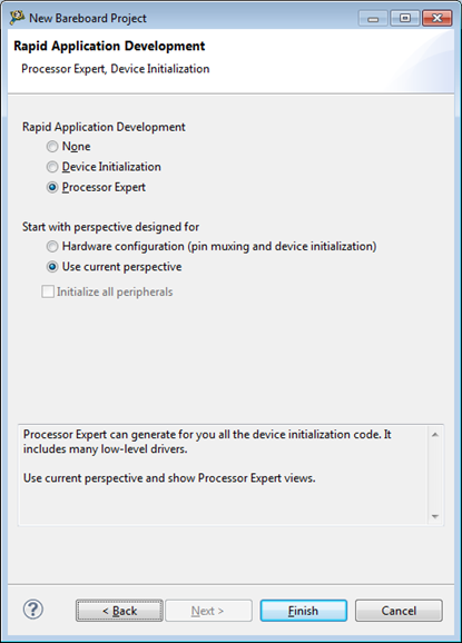

5. In the Rapid Application Development select [Processor Expert] and click [Finish].

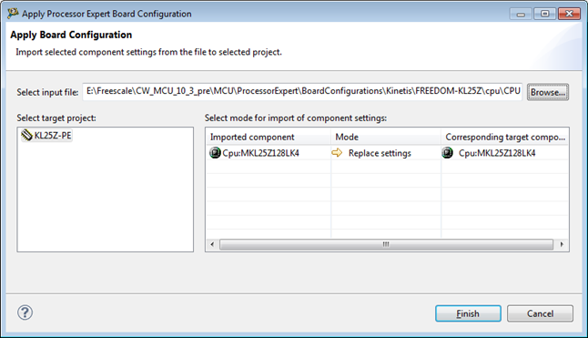

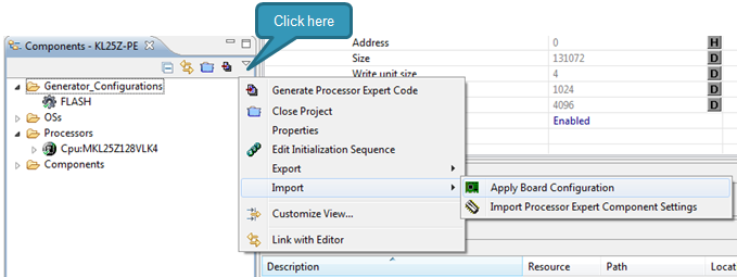

7. In the Component view open the view menu (small down-heading arrow) and select Apply Board Configuration command

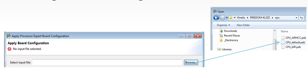

8. Click Browse… button and select FREEDOM-KL25Z / cpu / CPU_default.peb
9. Click Finish to confirm replacement of the default CPU component by the pre-configured one for the FRDM-KL25 board.
Now the project is configured to run from on-board crystal at 48MHz.
