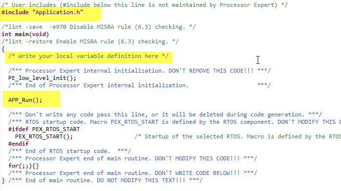

Hello
I started to use PE and suddenly I realize that it might not be the right tool to use, cause when I generate files, the tool step over code that I inserted in those files.
Two examples:
1 if I have UART driver and I need extra functionality, then I have to add it somewhere.
   If I add it in the AS1.c, AS2.c, …, next time I will build the PE project and compile the files with my compiler (IAR) then it will be stepped over.
  1. I want to do a lot of things in the main function, but it let me put a code only before the RTOS start.
    What if I want to put a code after that ?
Thanks a lot

Hi OM,
Application.h and APP_Run() is my own code I have added.
I usually make only minimal changes in ProcessorExpert.c, and kick off my application in Application.c.

BlackNight
Hi OM,
if you want to change the generated code and keep your changes, you can disable code generation.
See Disable my Code Generation | MCU on Eclipse
For how adding your own changes to main: see the yellow areas below:
I hope this helps.

om
Thanks a lot.
This solve a lot of things :-)
One issue:
In the "hello World" example that I based on, there is no APP_Run(); or #include "Application.h"
Is it something you manyally added, or you use different version of PE then I do ?
(Mine is Version: 10.2.0)

Hi OM,
