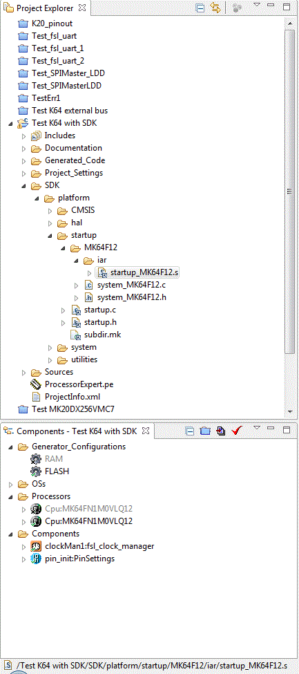

If you want to use the second options (and you use Kinetis SDK library and the Processor Expert in the project; the IAR ARM C Compiler is selected) you can find the startup.s files in the SDK/platform/startup/<derivative name>/iar/startup_<derivative name>.s folder in the Project Explorer. See below.

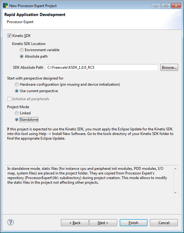

Please note that when Standalone version of the project is created you can modify all static files of the project without impact on other project (all files are copied into the project). See the option in the New Project Wizard in the screenshot below.
