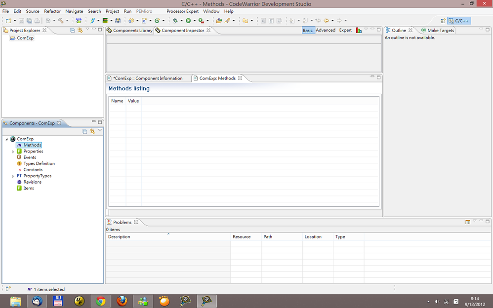

I have tried your suggestion and the project looks like this,
Is it already the Embedded Component Perspective in CW 10.3 environment?
Thank you very much.

BlackNight
Hi Stephen,,
yes, these are the views you need (a perspective is just a set of views).
Erich
