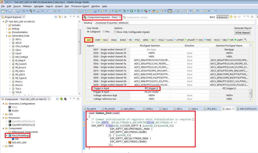

the development team has provided a workaround for this issue. You can use PinSettings component for routing of trigger signals, i.e. you can select the trigger source of the ADC (on the ADC tab) in the PinSettings. In this case the source code (SIM_SOPT7 register initialization) is properly generated in the Common_Init() function (Cpu.c generated source code file).
See the example on the following screenshot:

I have verified the issue and the ADC_LDD (Processor Expert for Kinetis) contains a defect in the driver. The SIM_SOPT7 is not configured. I have reported this issue to the responsible development team.

marek_neuzil
