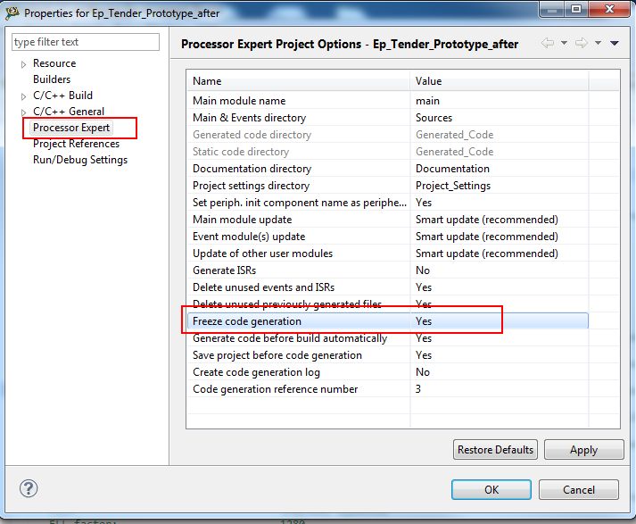

With the same code and the same settings, after update the codewarroir, MSCAN can't receive or transmit any frame.
In the SourceTree i saw the modification in cpu_config.h like:
Loss of clock reset:enable ---->disable
#define CPU_DEFAULT_FEI_ICS_C4 0x80 ---->0x00
Hereby i upload the two project before and after the update.

6,640 Views
Hello ,
I checked it on my side , it also like yours :
/* ICS_C4: LOLIE=0,CME=0 */
#define CPU_DEFAULT_FEI_ICS_C4                             0x00U     /* ICS_C4 value in FEI default state */
And if you change the "0x00u" to "0x80" , does it can work well ?

hanchengyang
I can't do so, because the code will generate every time I compile it, even
I have chosen "dont generate code" for CPU.

6,641 Views
Please freeze the PE code , do like this :
Alice
